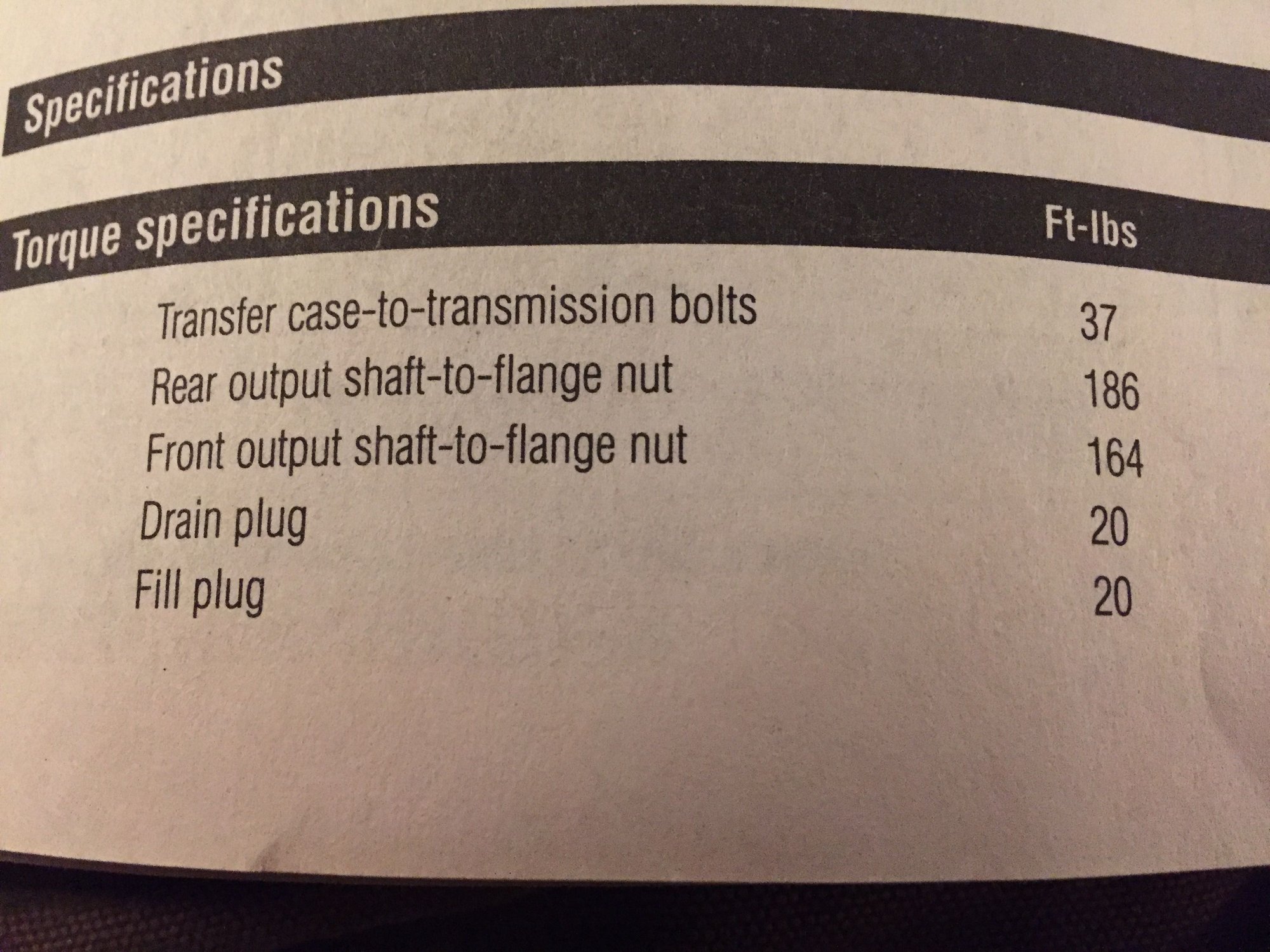

Originally Posted by Wayne Bulls
All my bolts came out. Anyone know the specs on the bolts? Ford is closed and I need my truck fixed by tomorrow!
Here's the specs per the Chilton manual
