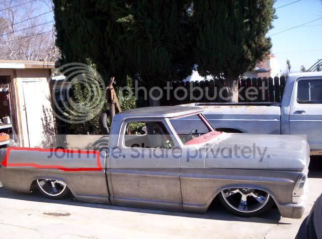

go to the junk yard and look for a bump truck with a long bed, the part that works good for roll pans is the top of the bed rail all the way down to the seam were the bump is. The part outlined in red is shaped and will work perfect for a roll pan. It's been done before.

its funny that you mention that marz I was at the local yard about a week ago and noticed a long bed with one good side. I was actually thinking of going there again next week to check it out a little better.
