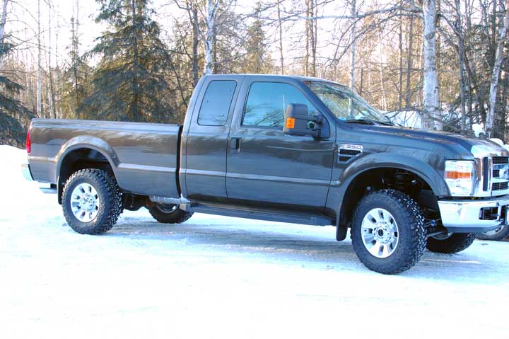

Heres a picture of them mounted on a 2008.
Note: This is not my truck but another FTE member. Hopefully he won't mind me showing off his fine machine.

Thanks. I'm trying to decide between the 33 x 12.50 18's and the 275 70 18's. the 33's look to wide but I dont want the 275's to look to narrow been looking for pics of this size!

I had a calculator for tire sizes and the 275 is around 33". Maybe a couple of tenths bigger. My truck looks just like the one Eng1Driver posted. The tires dont stick out too much and they grab real good in the mud.

what size wheels/tires are those?

what width are those stock f250 rims that those toyos are on?

The wheels are factory 2008 Lariat 18'' rims which are 8'' wide. The Toyo MT's pictured are size 275/70R 18 in load range E. That size is the same size as the factory tire which is 33'' tall. Toyo also sells that tire in a 285/75R 18 load range E whick is 35'' tall. Both sizes are ideally suited for the factory 8'' wide rim.
