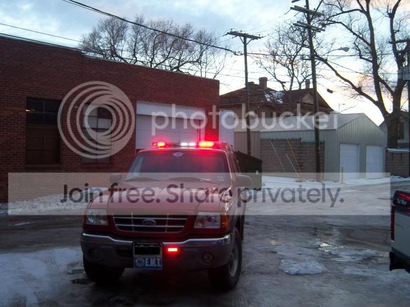

I have an 03 Ranger 4.0 4x4 XLT. I am wondering if anyone knows the output amperage of the alternator. I have heard everything from 90-110. I am running an all LED red lightbar with red grille lights and dash light along with a siren. Will all these along with normal draw eventually wear out my alternator? I have also entertained the thought of a second battery. There isn't room to mount one, but maybe someone has some ideas. Thanks all!

I know LEDs pull little amperage. Thats why i went with LEDs. The bar with the takedowns, alley lights, all the flashing lights, and arrow bar in back pull 11 amps. the siren pulls 4. the dash light and grille lights combined pull 3. 18 amps is a lot when I hear the truck pulls 80 on a 90 alternator. I always keep the truck running when the lights are going, like on scene.
