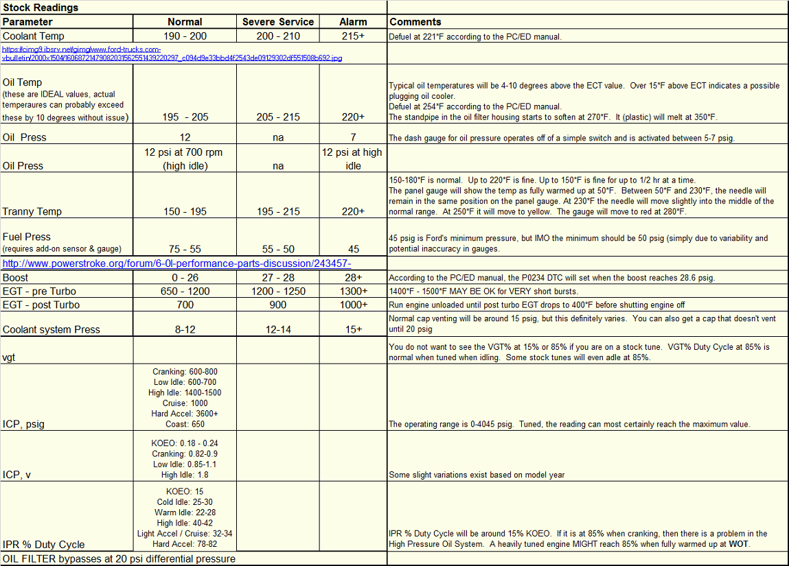

Here is a "first pass" at a list of the typical parameters and their normal and max readings. I do not have much first hand experience with these readings (no gauges YET), but I have done a fair amount of research. I would appreciate ANY and ALL comments - especially in two areas:
1. Fuel pressure minimum - FDDTS warns not to go below 45 psig
2. Readings w/ tuners - I would appreciate all your feedback in this area.
Lastly - send some rep points to TX25025. Much of this is from his past posts and some recent input.
Remember - this is a work in progress.
POST IS TOO LONG - I will post the tables in two more posts to follow ....

Do tuners really make these powertrains run that much hotter? Maybe if you were racing around a track (not likely in an 8000 pound truck) but it seems like just driving around town the temps should be about the same.
By the way, great post Bismic. Very helpful...who knows how many times there is a OK running temp thread.
Originally Posted by bismic

Originally Posted by jmaskew
I have had my Isspro Coolant temp gauge in for a couple of months now. The coolant temp for every day driving around town runs around 200 to 210. On the chart above that is severe service. On the freeway keeping constant RPM's traveling between 70 and 75, the temp will sit at around 195. These temps seem like the norm for my truck. Anyone else seeing similar coolant temps?
