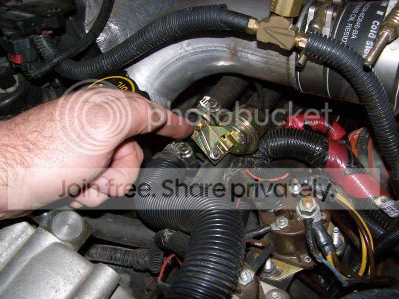

I used the white vacuum line and it only closes in MAX A/C mode. I have the valve installed from DieselSite. Takes about 20 minutes to install and it makes the A/C a lot colder than stock.

This is what you do to find out. Pop the hood and have someone switch from MAX A/C to A/C and while you watch the valve. You should see it open and close. That's how my son and I figured out that ours was working the way that it is supposed to. That's also one of the things we did when we were troubleshooting the vacuum leak to my hubs. Our valve stopped working when we had our vacuum leak. Once we fixed it it worked again.

Oh wow, never seen that one. Mine has a little arm on the outside and moves back and forth, opening or closing the valve. My finger is pointing to the valve in this pic.
