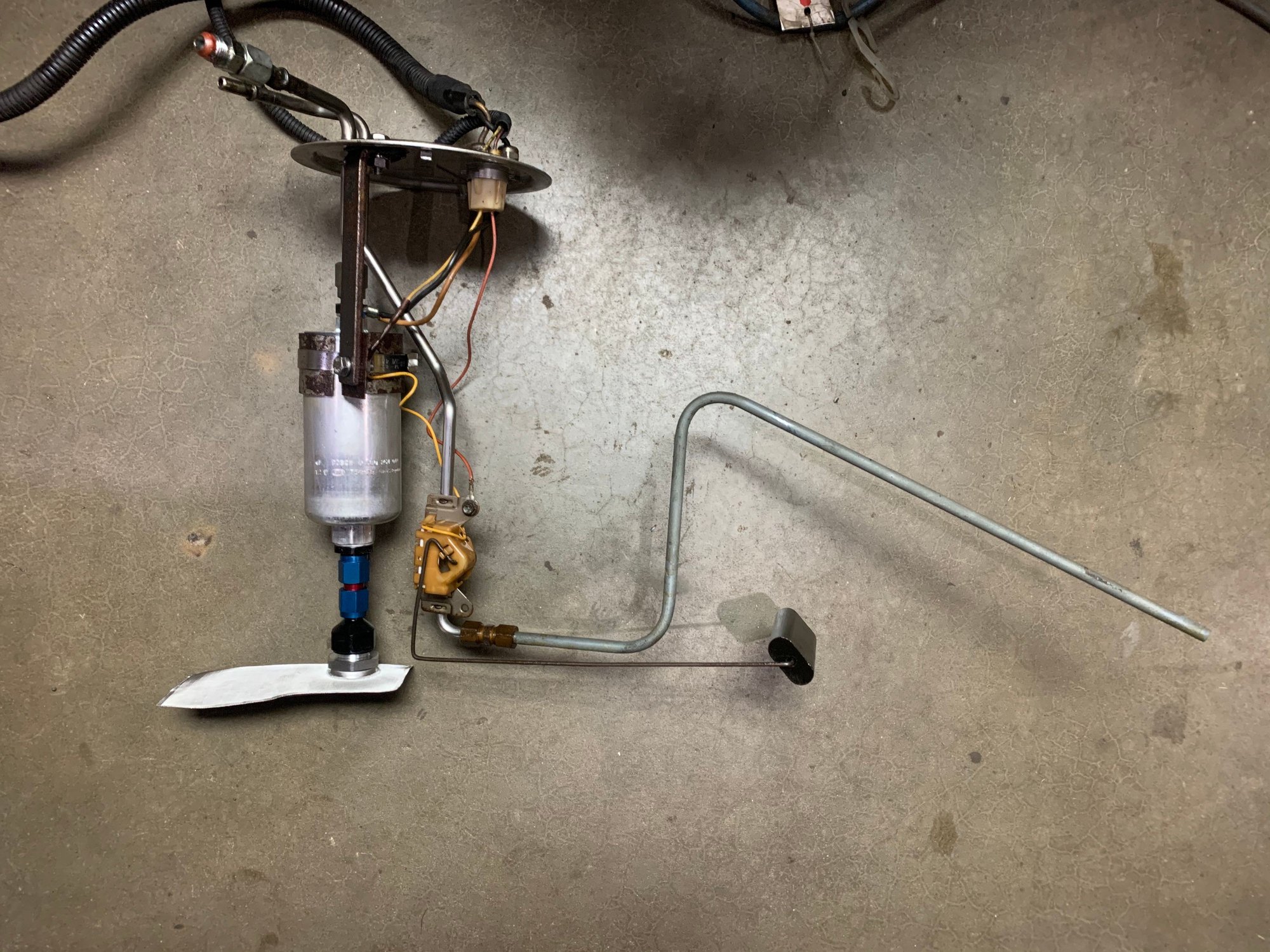

I'm going to revive this old thread for others to see and say that I'm still running the same setup as what started this thread. It's now 11 years since the last post and I haven't had to do one thing to it since then except change the filters. I bought a couple of spare fuel pumps as a hedge against the future back then and they are both still sitting on the shelf with no signs of any failure coming from the first pump I installed in prior to 2008 sometime.

This is the current version of the mod. It has been in there since August 2020.
