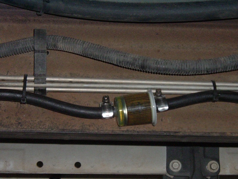

Quick story: I apparently got some dirt/junk in my fuel tank recently -- I was driving in to work this morning and the truck suddenly lost power and would barely make any boost. Check engine light came on a day or two ago, but I haven't had time to go find someone to read the codes. I pulled off the tollway and got lucky -- that particular exit had an O'Reillys Auto Part right there, so I whipped into the parking lot. I thought maybe I might get lucky again and they'd have a code reader, but no dice. Back out to the truck...
Started it back up and still running crappy. Shoot. Then it dawned on me to bend down and look at the filter I put in place when I did my in-tank mods. I used one of those clear gasser types and I saw it plugged pretty solid and starting to collapse. Went back in bought the same filter, a set of screwdrivers (needed a new set anyway ) and a roll of shop towels. After a slight bath in fuel, and a about 20 minutes, I was done. Truck back up & running. I hope they don't mind the little puddles of diesel I left...
So now I'm adding another one of those filters and a screwdriver to the emergency repair kit. I kept the filter, but I didn't have time to get any pics just yet. I'll post some up here shortly. I'm just *REALLY* glad I did the in-tank mods when I did. I would've been looking at a plugged mixing chamber at least, and maybe a mucked up fuel pump, too. If you're putting off the Hutch, don't wait any longer...

Absolutely worth it -- I went with the non-filter version (it's only about $40 without the extra filter) and put in that clear gasser filter I mentioned. I don't know if O'Reillys carrys the type of spin-on filter that Dennis sells with the kit or not, but I was happy to see they carried the little cheap-o one I used. I'm still out in the company vehicle right now, but I'll snap a couple pics of the little filter that saved my butt when I get home.

The filter I put in is just a $4 cheap-o from Wal-Mart, and now I know O'Reillys has it too. Here's what it looked like before it got all plugged up:
Attached is what it looks like now (sorry for the bad pic, I just snapped a quick pic with my phone).

Woaw, thats plugged all right!

Don't forget to check your main fuel filter too. I can't imagine your little as filter would catch everything.
Look on the bright side. You could have been up north with temps in the teens with that kind of wind. Too bad you didn't break down yesterday.
Yep, I'll have a look at it tomorrow. I hope it's okay -- didn't put it in that long ago. And yeah, I don't do cold very well...
