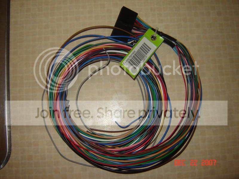

Mine is only the keyless entry. It came with a fairly large wire harness that runs from the module. There are quit a few wires that these run to. I really only need to know what color wires on the truck that these hook up to (do they match the wire harness colors). Also where is the best place to mount the module. The only other thing that is puzzling me is the module has slots for fuses. These slots are not labeled well and in a few cases there are three slots for one fuse (by this I mean that there are three places where one of the legs of the fuse could plug in so i guess there is really two places the fuse could plug in.)

here is a pic of the module. notice that the top three fuse pins on any one row is labeled to be one fuse.
here is the wiring harness that came with it
