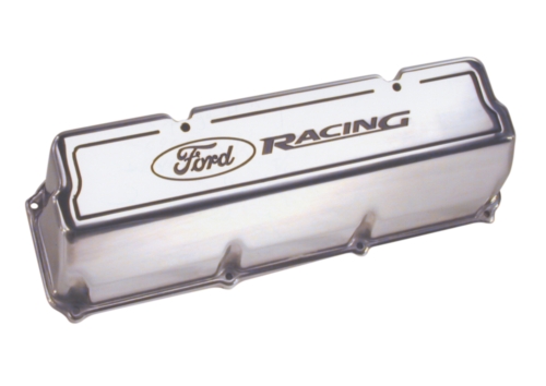

Hey there, I just bought some new Polished Aluminum Ford racing valve covers for my dads christmas present.
I just have a few questions...
It has no hole for the breather, but they came with a breather and there are 4 circular indentations on the inside of the valve covers. Do I just drill one of them out to correct size?
And they have no oil fill, and I notice most aftermarket valve covers don't have one. How do I fill it up? I noticed the location where the stock oil fill would be had the circular indentation and some bosses for screws, (the valve covers came with screws plus some sort of plate) I can't check now since the gift it wrapped.
Could someone shine a light?

Not sure about your valve cover set up, but on mine both holes came drilled on pass side: pcv valve toward back of motor and driver side: open breather toward front of motor. One side had a breather/pcv and other side had the open breather. I fill it through the open breather side. I would say that you drill out the circle to the right size. Don't forget to install the rubber grommet. The valve covers should probably come with instructions.

No instructions.
They all come undrilled.
I drilled and filed mine myself.
They do come with 2 rubber grommets.
One for the back right for PCV valve
One for the front left for a PUSH-IN vented oil filler.
Need a pic ?
On the same topic :
What engine and what size brake booster is this going in ?
The tall valve covers won't fit on 460's with a 11" booster and a truck with Integral AC

There are the ones that I got for a gift.

Hey looks good, the ones I got for my dad look the same for the most part.
