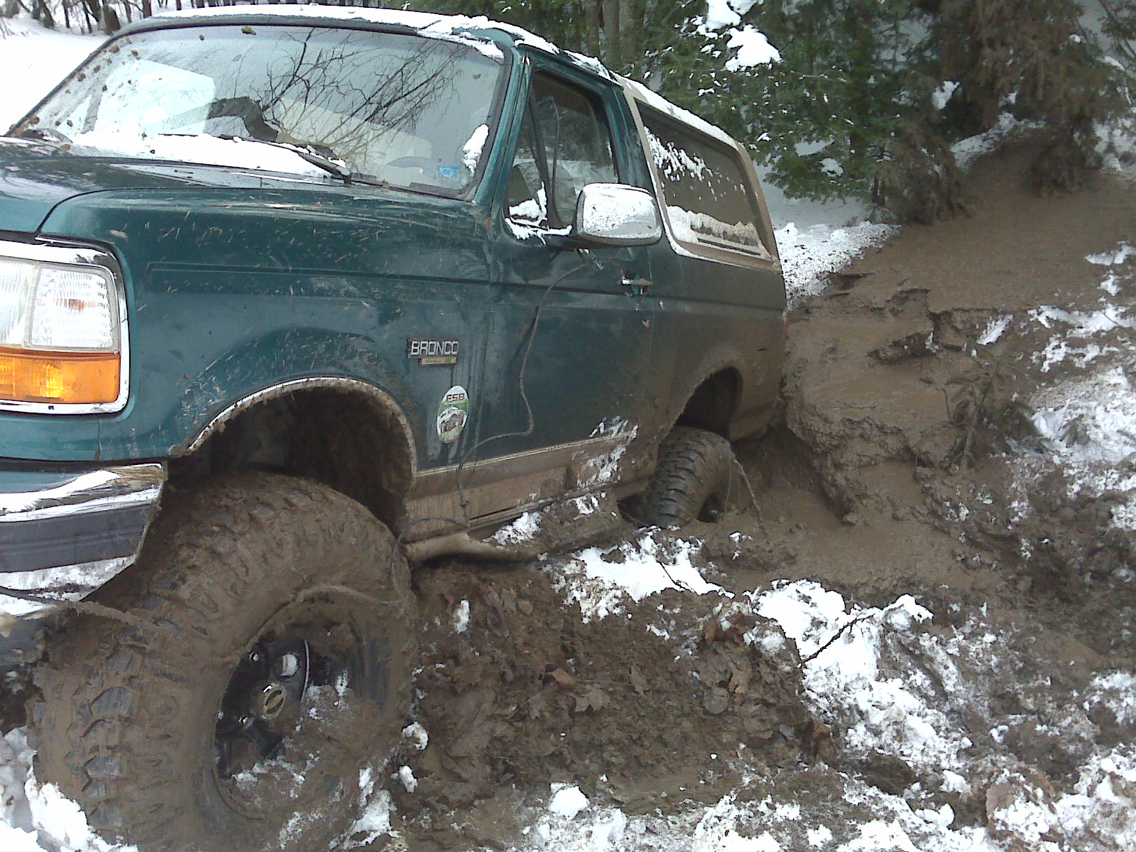

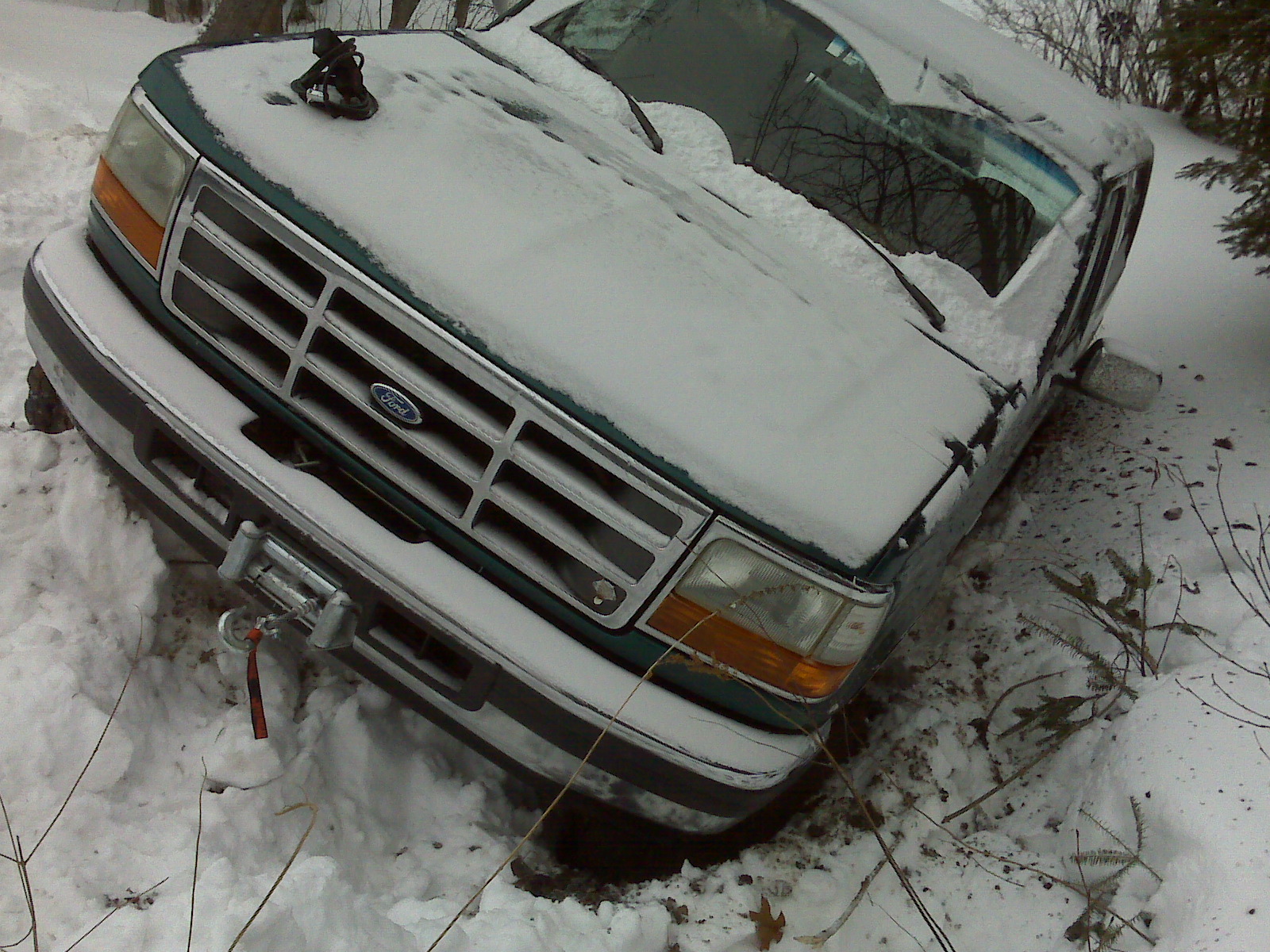

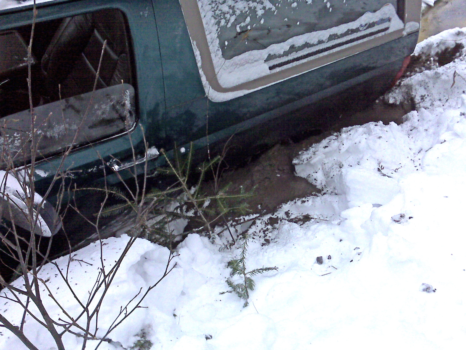

If your going to tear the hell out of your bronco than find a sterling it has the VSS also. I'm running the 8.8 with 35" tires and have driven it hard and it has held up very well, infact it hasn't given me any problems. If I break an axle they are easy to come by, in fact I have spairs in the shed. If you were running larger than 38" tires I would be concern and sugest you upgrade - that being said; a person can break anything if they try hard enough.
Heres some pics the day I broke my front axle
