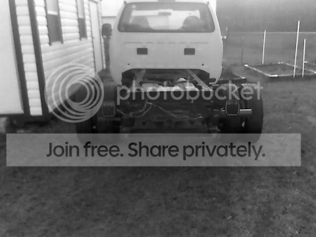

I am going the same thing your going thru, I bought a cab and chassis ( F-550 )and I needed a bed, I looked at lots of flatbed styles and I just don't like the looks of a flatbed. I searched all over and I found a regular pickup bed and put it on and the cab ended up 3" lower and no way of lowering the bed, now I'm getting a 3" body lift together to get the body lines to match up.
here are some pictures of what I have? ( lot's of work )
and it's off by this much Grrr
The flatbed is the easiest way and cheapest
like others have told me
Good luck
