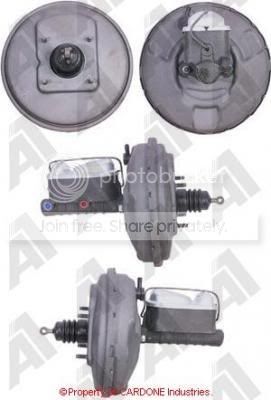

1977- 79 (Pre DJ0001) F350 booster

OK........Now I'm back on this subject again. These are the two from Rock Auto.
1. For an F250 pickup part number 509335 (with M/C)
2. (as Dennis suggested) For an F350 Pickup Part number 503311 (with M/C)
Is there a difference in mounting these to the firewall? (ie. direct bolt to the firewall or bolted to brackets).
I am swapping in a 460, and I'm not using tall valve covers since I have A/C, but would either one bother with motor? And if not, what would the main difference be between the boosters AFA performance?

There should be any difference Buck
short rod
From 77 to 79 (DJ0001) they will fit.
I recommend to install the fulcrum mount to the booster first then install the whole on the firewall.

You want option 2, Buck. For what it's worth, when I did mine, I used the straight through on a 77 cab. I hunted all over the junkyards for the brackets, only to find out later that you can get the same booster for the linkage setup.
Another thing is to watch freeplay. Mine was ever so slightly tight, and my rears locked up on me. I ended up using a 1/8" plate for a spacer, but I don't know now the linkage setup adjusts. Maybe it's better?
