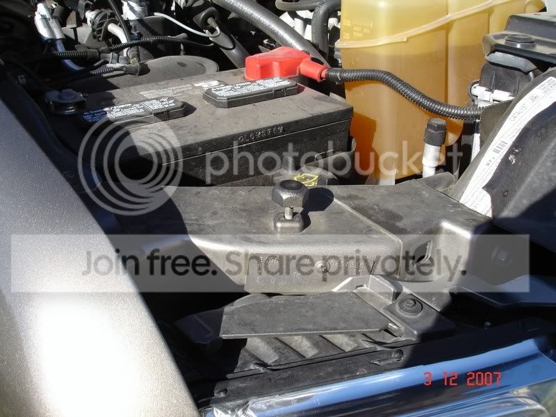

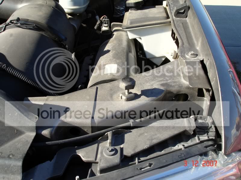

Here are a pic's of the stops i was talking about that i moved up and down.
On mine this one i had to raise up a little bit. It's above the passenger side headlight.
This one i had to lower some. It's above the driver's side headlight.
Hope this helps...

This should help a ton. When i get back this weekend i will look to see what side needs to be raised. ill post the results and pics if i can get some. thanks again for the tip!
