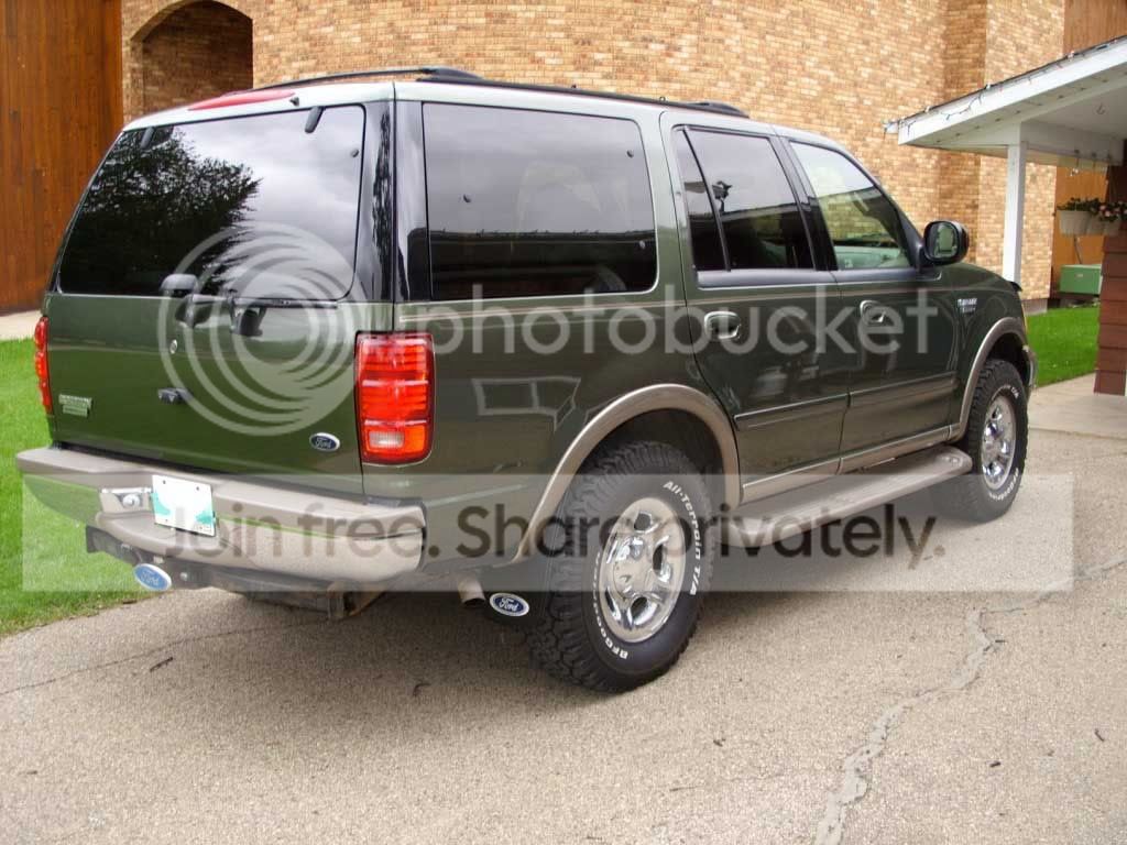

Here's mine. 285's
No rubbing issues at all.

stock?
Stock suspension?
Originally Posted by SMIGGS
Here's mine. 285's

Originally Posted by 1pfieffer1
Stock suspension?
Yep, air suspension on all 4.
