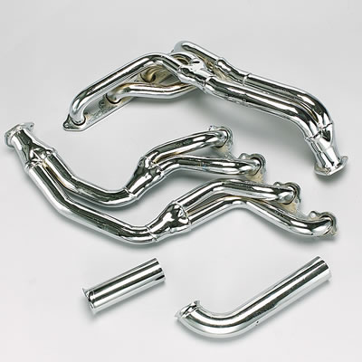

thanks for the feeback guys. any perticular your suggesting tri-y's? what exactly are they? im kinda new-ish to the performance thing so need a lil help every now and then.
Heres a pic of the Doug Thorley Tri-Y headers. Notice where the 2 front and 2 back pipes merge in the mid section of the header. The 2into1 merge looks like a "Y" thats where they get their name. It is a proven design to enchance low end and still provide good mid and top as well. They are better suited for heavier trucks.
