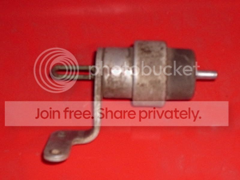

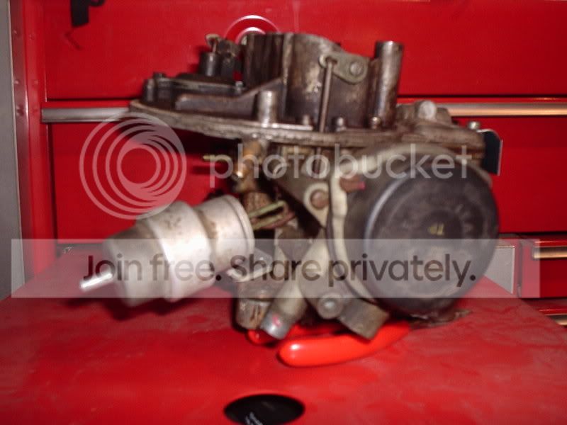

Well I guess I figured out how to post picts. Its the part that hangs out to the left. Leave it to me to have a one year part. If I can't find a new one will an electric choke be better?

Thanks for sharing those pictures. I have to say I haven't seen that before. I would say, though, that as long as the choke pull-off and the choke cap work properly, you can get away without it. I would just leave it off. As for an electric choke, there really isn't any reason to switch to one unless you're having problems with the hot-air choke. I run a hot-air choke on one of my vehicles and it does great. Originally electric chokes were introduced as additions to the hot-air system so that the choke would open faster and reduce emmissions. Nowadays, however, you can get fully electric chokes that tend to be less problematic. However if you don't get any trouble with the one you've got on there now then there is no need to replace it with an electric one.
