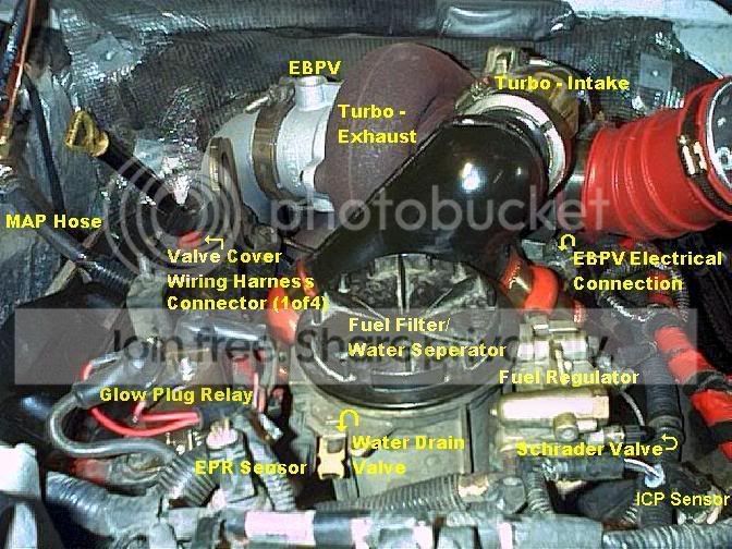

Look on the left side of this pic and you will see it labeled:

Thanks Scott. I appreciate the picture. Can't get any more straight forward than that.

So just wondering. The EBPV sensor is the one off the front of the oil res. it senses exhaust pressure from the manifold and then tells the valve to open or close?
