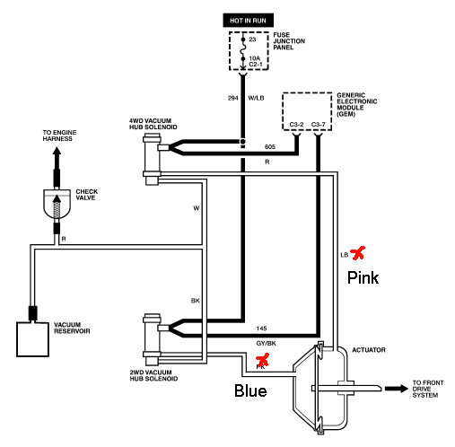

This drawing helped me when mine wasn't working. One of the vacuum hoses had fallen off the solonoid.

See my thread here https://www.ford-trucks.com/forums/6...ive-issue.html . In the picture, you should see the solonoid move in and out if you are getting the proper vaccuum to it.

well i thought i wud get out there today and try to fix my problem, first i removed the cover on the little vaccum thang on the front diff. and moved the thang in and out good ...... so i took the vaccum lines off of it and blowd air up threw them ..... then i get up under the hood were there is like a plug on the fender wheel plastic skirt thang and try to unplugged the bigger vaccum line that runs into the diff down below .... and i broke the little white plastic splicer thang ..... so i finally rigged it back together and went to plug it back up and the blue & pink vacumm lines on the other side of the plug just crumbled .....so now im gonna just take it to the dealer and tell them to fix the mf'er ......
