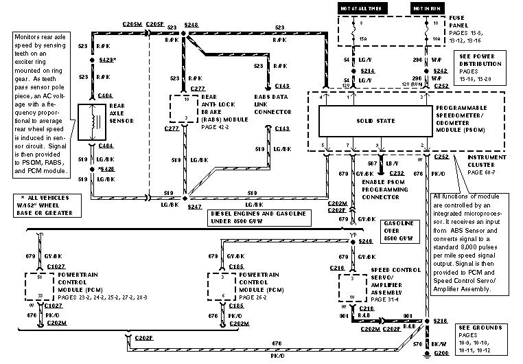

Need some help guys. 1996 F250 4 wheel drive diesel. Today the ABS light pops on, so I do the easy thing first.Headed to Autozone and purchased a ABS sensor which mounts in the differential. Easy and no problem installing. Took it for a test drive and now the ABS light is still on and the speedometer is jumping back and forth. Cant even run the cruise because of the speedometer jumping so bad. Question is are there 2 speed sensors on this truck? One on the differential and possibly a vehicle speed sensor on the tranny. I climbed under the tranny to see if I could visually see a sensor. Honestly I didn't see anything on the tranny. I dont have a manual yet so IM guessing here. I only see the one sensor in the differential. Is that all or am I missing another sensor which controls the speedmeter. Im sort of figuring I got a bad sensor at autozone. Any suggestions would be helpful. Thanks maxx

Nope, no other VSS. Take a look at this. The module your replaced is the Rear axle sensor in the pict.

Check the transfer case. The case can have 2 sensors (high/low and speed). The sensor on the output shaft is speed. Its on the drivers side rear.

That will not fit a diesel. You need to ask for a RABS (Rear Antilock Brake Sensor) It sends a signal to the PSOM that makes the speedometer work. It's on the top of the rear differential. Sometime just rmoving it and wiping the crud off it will solve a jumpy speedo.
Does your OD lite on the end of the shift lever flash on/off? If so that sensor is you likely culprit. It may be the connector too. Look for corrosion or bent pins/sockets.
