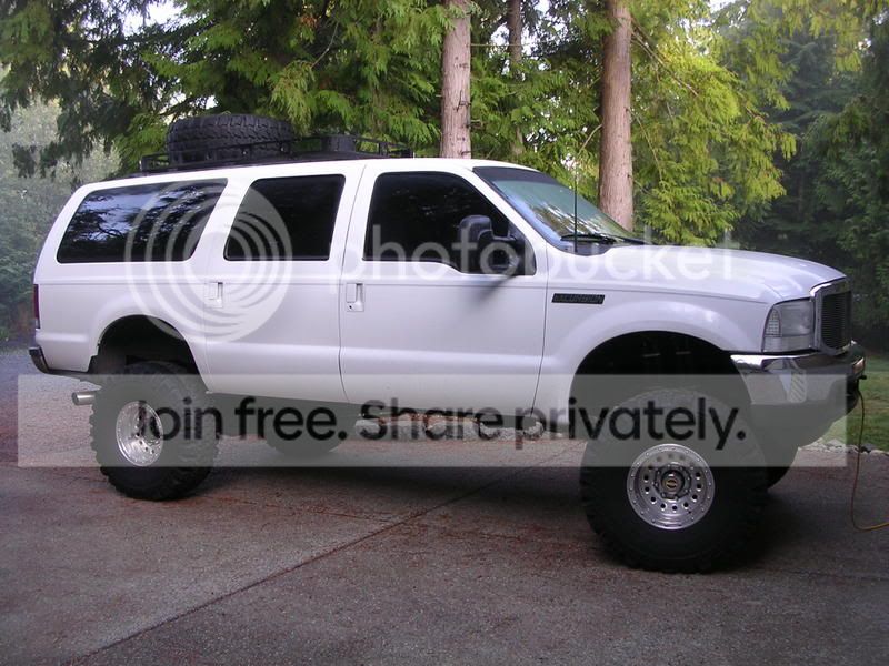

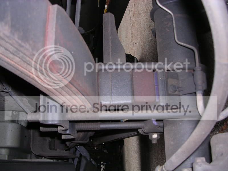

So, as some of you are aware, the 2001 Ex that my wife and I just bought came with a lift (8") as I have been told. However, the owner couldn't remember which manufacturer. So I am trying to figure out what lift I might be.
Here are some of the details that I could figure out.
It is on a 2001 Ex (4x4) with 7.3 PSD
Seems to be an 8" (or very close) lift with 38" tires.

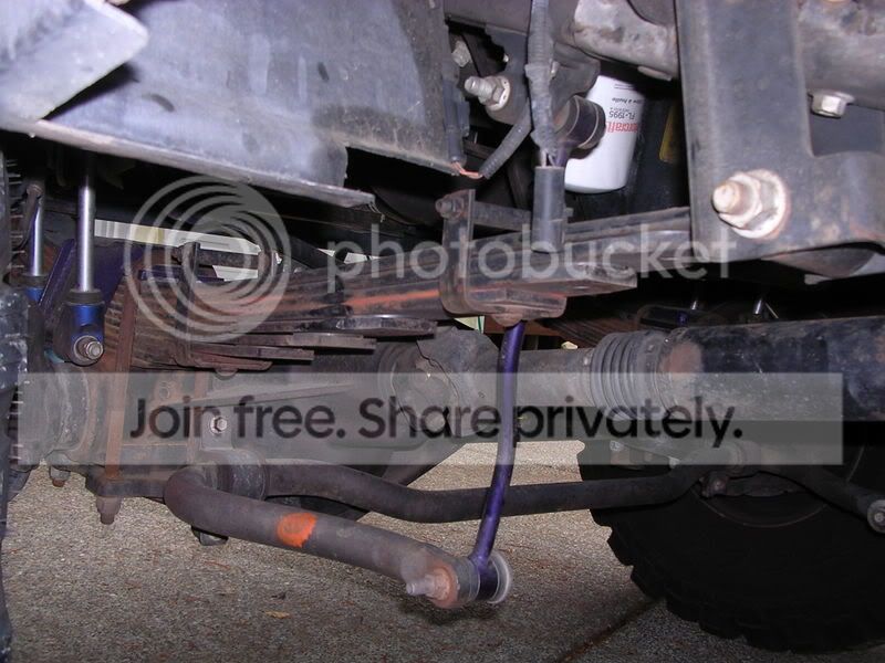

Front:

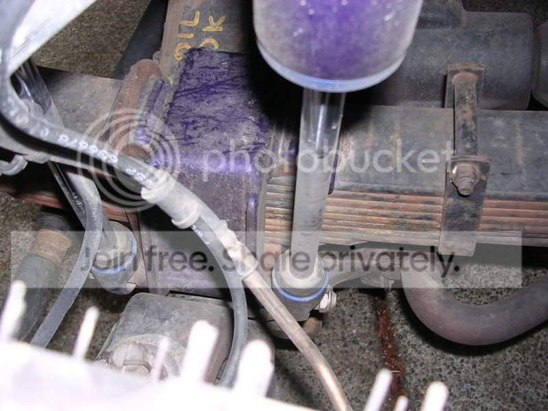

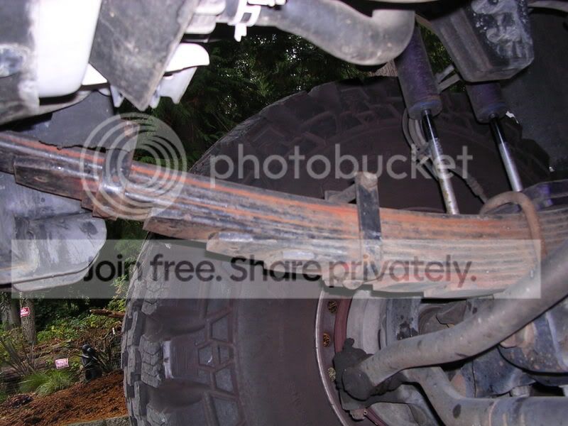

The front leaves are a 10 leaf pack with 4 retention clips per pack (2 in front of the axle and 2 behind).

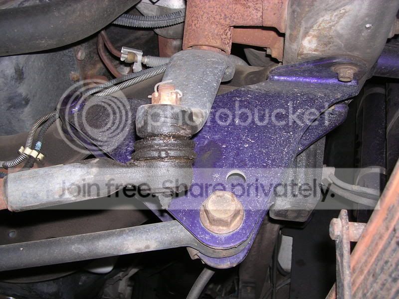

The track bar is not adjustable and comes with a drop down mount on the frame to match with the drop pitman arm on the steering.
Bumpstops seem to be aftermarket and taller than stock.

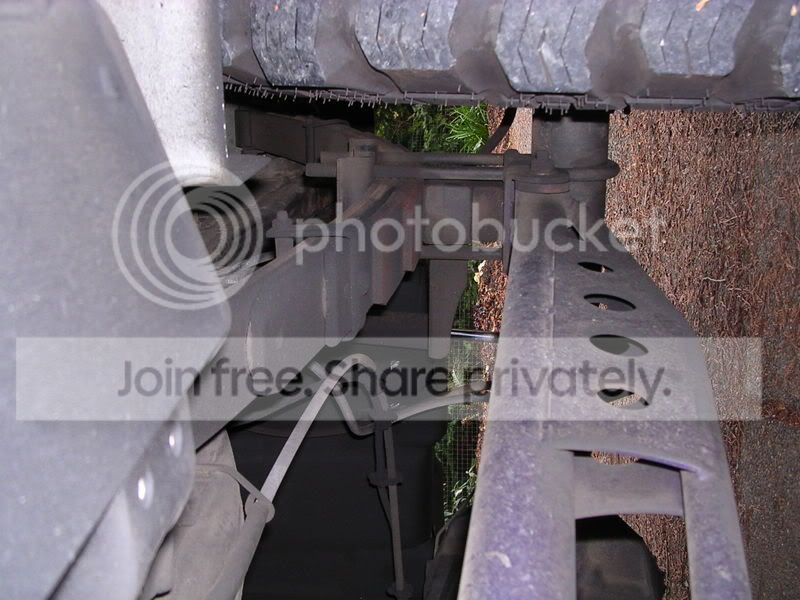

Rear:
The rear leaves are a 6 leaf pack with about a 2" block stacked under the stock block (I believe?) and there are only 2 retention clips per pack (1 in front of the axle and 1 behind).

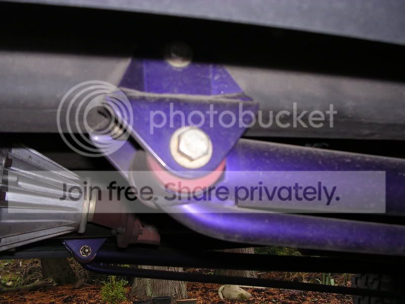

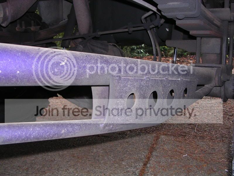

There are ladder bars or traction bars on the rear that I suspect don't necessarily match the manufacutre of the lift (red bushings, different from the rest of the components).
Shocks:

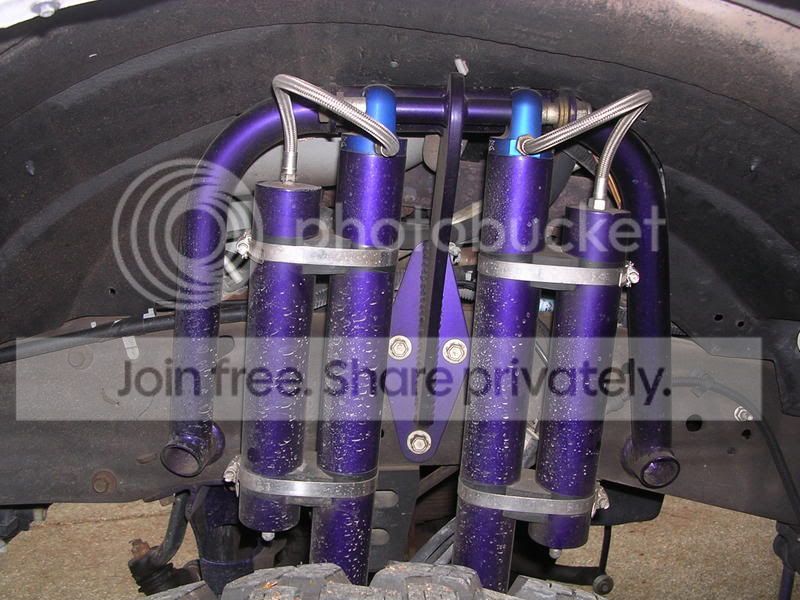

It has Fox shocks all the way around, I have not measured or checked the part numbers on them. Twins up front on a shock mount with resevoir shocks and singles in the rear with no resevoirs.
There is no steering stabilizer at all.
Question. I was going to get a steering stabilizer (maybe a double?) and have been told that might help with the little bit of bump steer? I don't usually like to mask bumpsteer with a shock but could it help? It drives good and is no stiffer than I would expect with a large lift on a big truck.
Also, There is a transfer case drop. About 2-2.5".
I would love to take that out, I am guessing I would have to re-shim the rear axle and possibly get a new rear driveline? Or is there a chance I might not have to do 1 or either? Any advice here?
Any advice or insight at all is appreciated.
PS. many of the lift components were powder coated blue/purple. I don't believe they came that color.
Thanks,
Michael

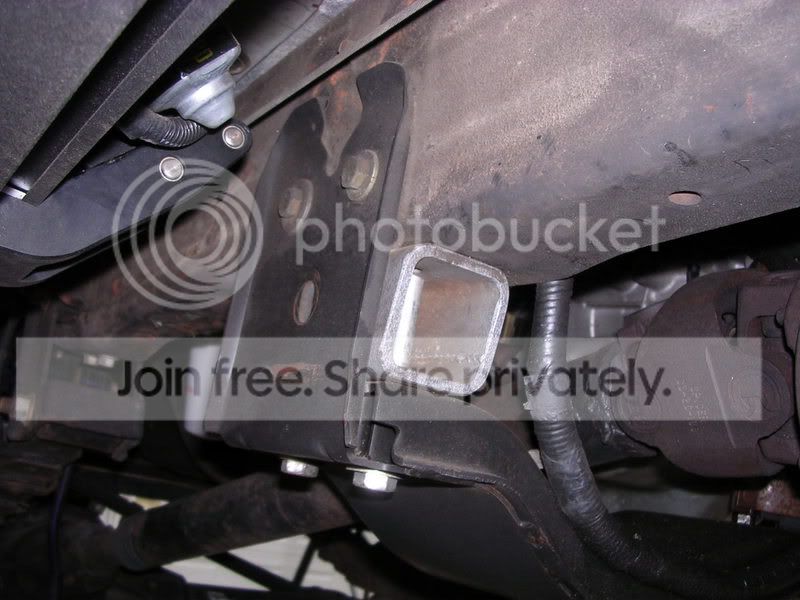

Looks like a nice lift and x. I did notice in you fourth picture of lifts, that it looks like your missing the bolt on your track bar relocation bracket, near the oil pan. I know thats not the question you were asking, but that bolt should be there.

The bolt for the track bar drop bracket is there, it is recesed in that whole. I assume that the additional hole that is not currently filled is for moving the trackbar up to the stock or alternative position.

I think that bolt is recessed.
