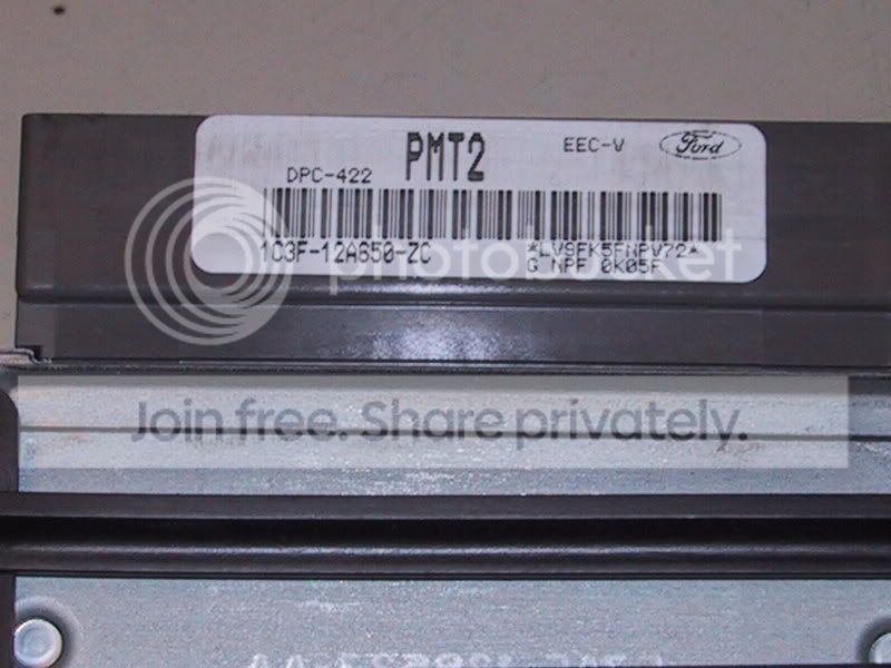

I pulled it. Which number is it?

Oughta look something like PMT2 or NVK4 or similar.
Edit: Here ya go:

XLEA above the bar code and in large font?

Probably it. Look at my last post, has pic now.
