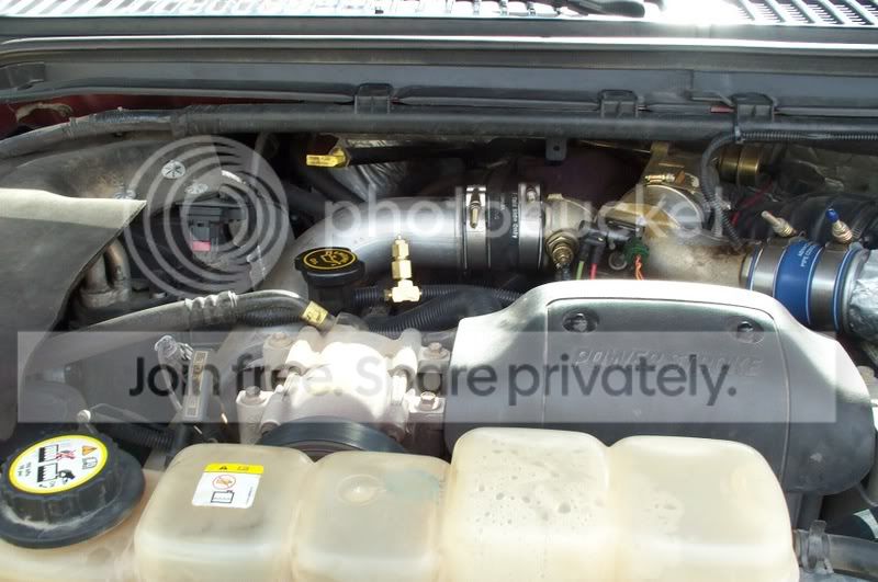

Old Sep 25, 2007 | 06:41 PM
Texas Outlaw's Avatar
Texas Outlaw
Not a liberal...
Joined: Jul 2006
Posts: 6,635
From: Cut & Shoot, Texas
Upper right corner of pic. It's the red line going into the top of the waste gate. Unplug it and connect it to one of the studs on the boot.
