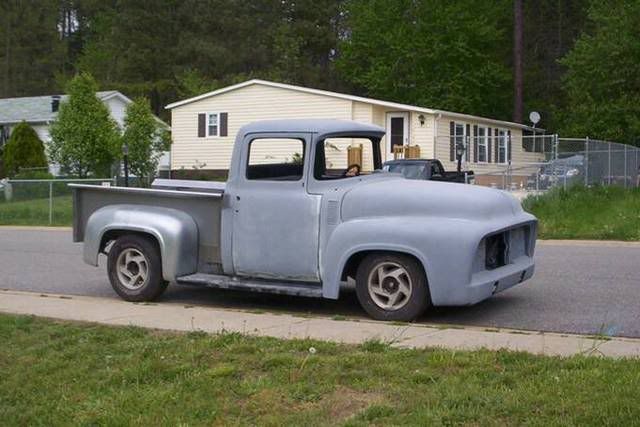

Here's a 56 installed on a 93 Explorer chassis that a buddy of mine did. After completion, he did say it still has a rough ride, I guess the springs are too stiff for the weight.
Mocked up:
Completed:

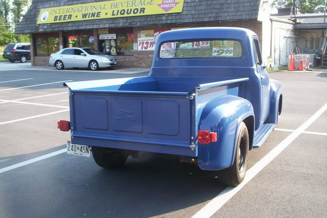

Here's a picture of my old truck, sits on original frame except for the LTD front clip, rear lowered by raising spring perches.
And this one rides like a dream. The clip was grafted to the frame such that you can not see where it was done, and have had no issues since it was built. I'd say unless someone butchered your LTD clip install, you should have no problems with it. If your frame is still sound, I'd look at fixing the spring situation in the back, and keeping your frame. I'd hate to see you install a modern frame and go through all that work just to still have a poor ride because it was not designed for your truck. There will be a lot of work either way, but I think you have a good starting point with what you have.
