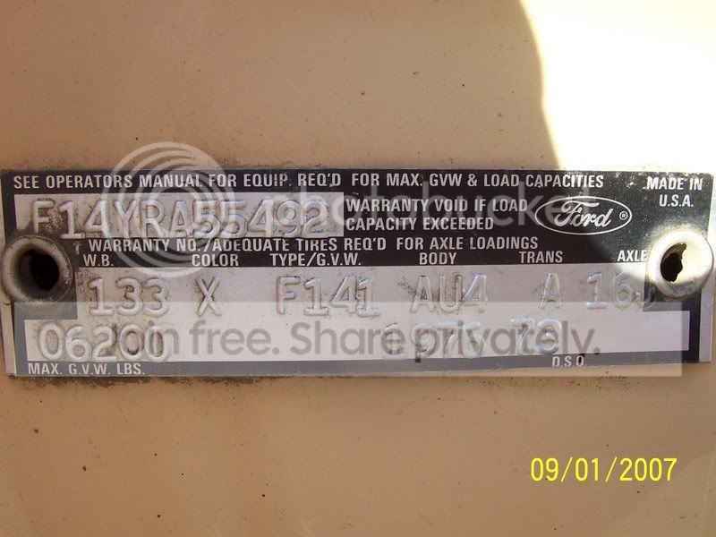

can you decipher these please?

with this i.d. tag? I can decipher the vin but not the other numbers. Thanks!

133= 133" wheelbase
X = Exterior colour = Tan
F141 = Pickup GVWR code =
AU4
AU = Vinyl Tan Bench seat
4 = Styleside Box
A = Trans = NP435 4-spd
16 = Axle = 3.50 Open axle
J = Power steering
DSO = District Code - 73 = Delivered to Salt Lake City

Thanks Dennis,that was very helpful, especially the tan vinyl seat code
So helpful in fact, I am going to print and put a copy in my Ford Engine Rebuild book.
