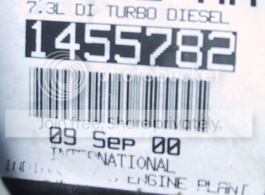

Yep, I ground down a bolt, no socket extention fits the plug, at least what I had. My engine, INDY plant, 9 Sep 00, it has PMRs.

Cookie was yours made in the Indy plant too? Exact damn same build date on the engines but different parts!

Yeah....that is frikkin odd, but Mikes engine has been something of a mystery ever since he discovered the PMR's. His the only only truck I've seen built before October that I've heard of with PMR's.

Tell me about it. Almost makes me want to go back out there and look again, but I spent too much time trying to see something that I wasn't going to see the first time. Maybe I needed reading glasses back then already, LOL.
Maybe I ought to get a pic of the rod cap itself.
