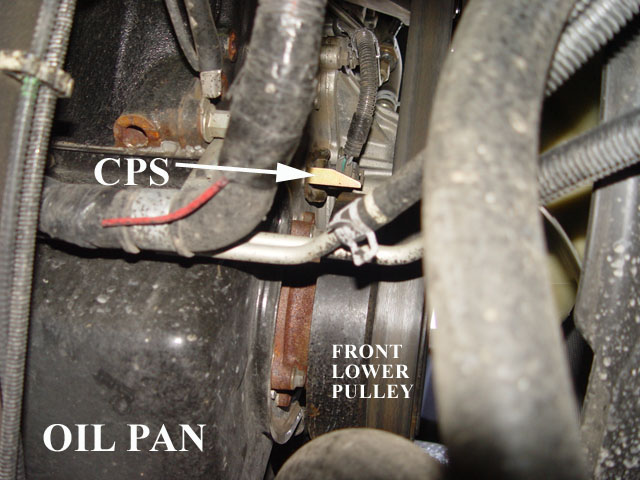

Did you dunk the front of the motor into the mud, if so you may have got the CPS wet ot muddy. It's on the front of the engine about 10 oclock when you looking at it.
Here's a pict of it looking up.
https://www.ford-trucks.com/forums/a...tid=3766&stc=1

it looks lil dirty like it could of gottn wet, but if that were bad i thought it would just not run at all, she runs, but has no power
