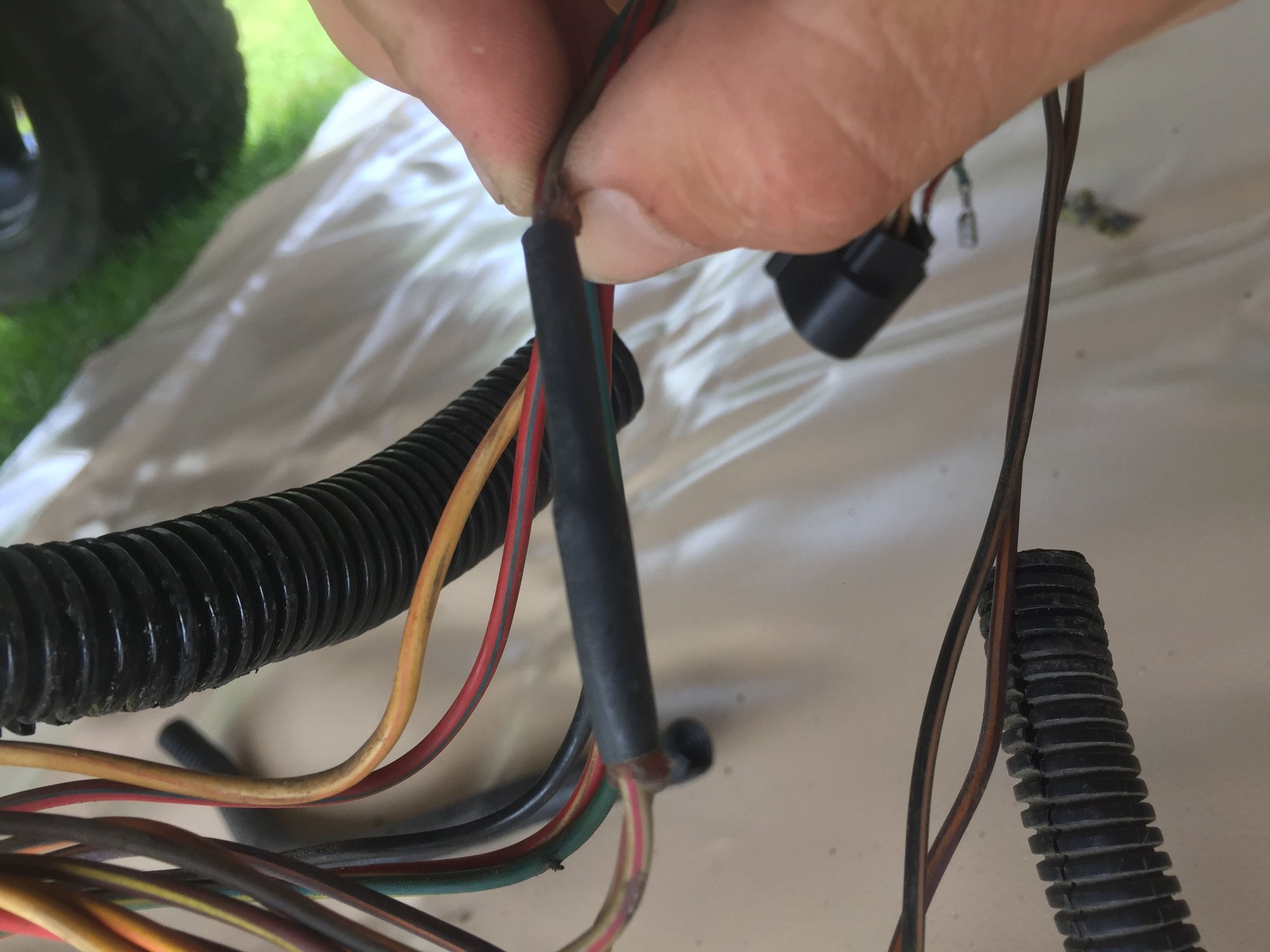

I found this splice in the harness it's (2) gray and red wires going into (1) gray and red wire .Its the signal return wire for the mlps ,pin # 359 .would you know if that is the factory or previous owner splice

I removed the harness from the transmission all the way up to the fire wall and did a continuity test and all checked good there , I'm lost on where to go now
