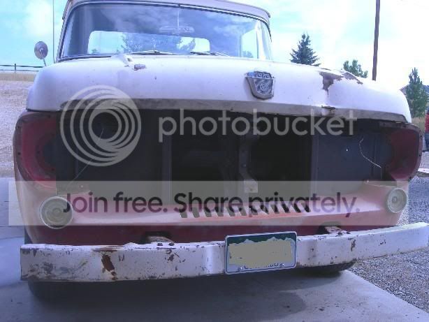

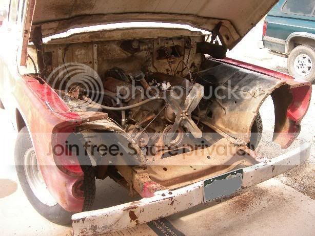

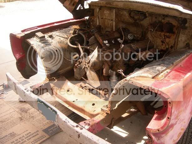

Well after 2 weekends worth of work we finally got all the front pieces off to get the engine out (see photos), couldnt believe how many bolts held it together. Now we're finally getting ready to pull the engine/transmission, anyone have any tips/advice?

The reason we didnt eas because of this, im not sure what you call it, its a black panel that holds the radiator/fenders to the frame but sticks up well above into the hood. In order to get it off we had to tear everything else apart, turned out to be a bigger job that we thought but will make it easier to do the body work.
