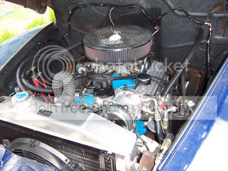

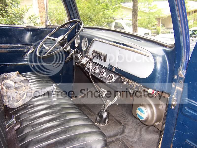

Well, I have a 51 F1 also with a 302 and automatic. I still retained my Magic-Air fresh air heater and installed underdash a/c. I got the kit complete from MustangsUnlimited.com. It came with everything and I mean everything you would need. Mounting brackets, belts, pulleys, compressor, evaporator, condensor, drier, hoses, pressure switch, wiring, etc.. It was around $900 and seems to do the job here in the humid hot south. My wife calls it "The Super Chilly"

I have a Vintage Air unit in my 53. It could not perform better. Far better than previous [ Southern Air in my 46, AirTique in my 40 sedan] units I have used. I will not buy anything else. Just bought one for my 40 coupe. My F100 is well insulated and sealed and that makes a big difference I know. Now that I have experienced one that works very well, I'm stickin' with it. I will say that I do believe an under dash unit makes a lot of sense in our trucks and might just put more cold air on you to offset some lack of insulation. Joe
