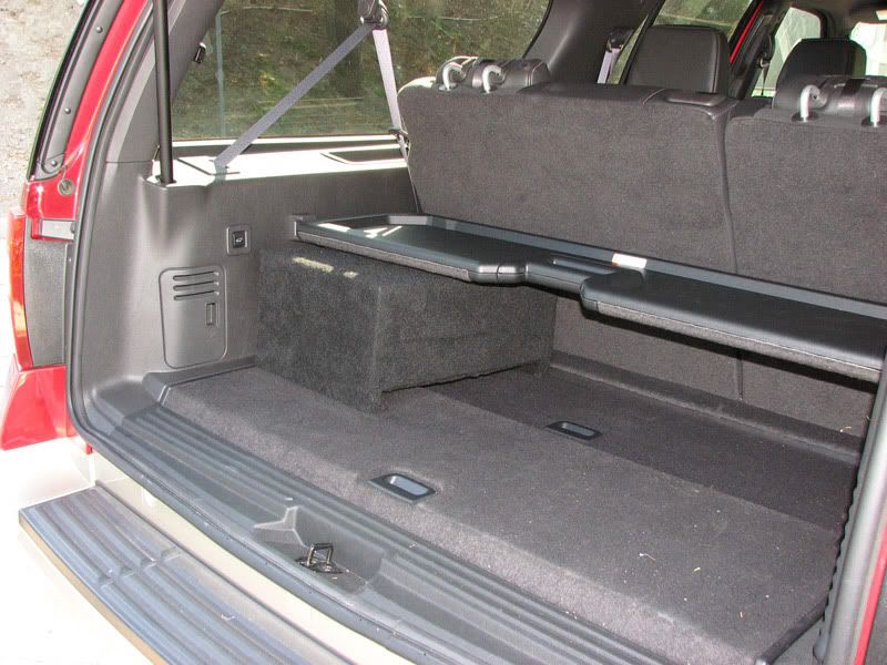

Alright, as promised, here are some pics... not much to look at though!
Polk db6501 Component Tweeter mounted in factory location.
The JBL GTO755.6 II is hiding in there somewhere...
Slightly zoomed in...
...and a little more...

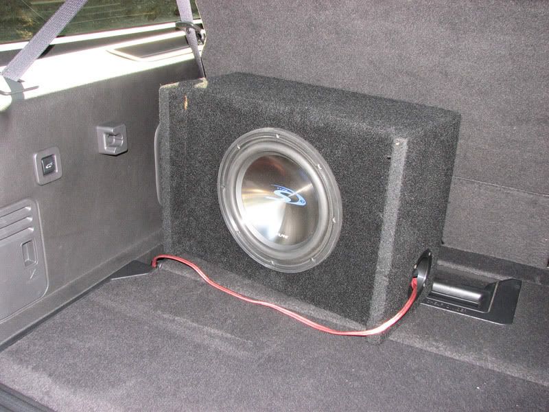

Downfiring Alpine Type-S 10" sub...
The shelf can still be in the "up" position with the sub.
Yes, there really is a sub in there!
Last but not least, my sub gain control.

Jason, thanks for the great pics! What a nice job!
At least now I have a direction that I want to proceed. Btw what are you using to tie into the factory head unit? Are you getting any distortion? If I recall you have the amp feeding your sub woofer and the rest of the speakers is on your factory amp?

Thanks Carbon... I'm very happy with the system now.
I have a Line Out Converter coming off the headunit and connecting to the 6-channel JBL amp. That amp is pushing 60w RMS to each door and 300w RMS to the sub. I can turn it up extremely loud (as loud as I can comfortably listen) without any distortion at all. As you may have noticed on the sub gain control, it's only turned up 1/2 way too.
