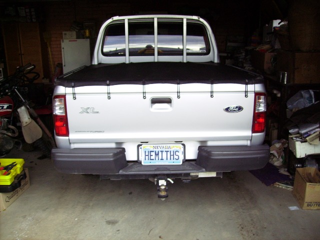

Time to design the "Hemi this" bumper sticker.

Twins....
Hemi this huh?

Originally Posted by IB Adrian
Twins....
Hemi this huh?
Dang it. Now I can't get that for my plates
