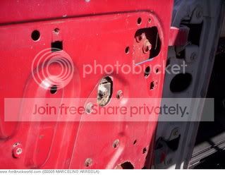

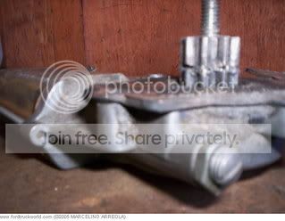

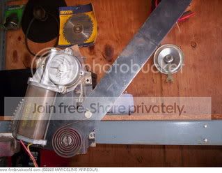

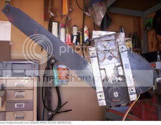

This is what I did with my 68 f100.
I used the stock setup and added 89 mustang electric motors.
This is the finished look!

thanks for all the ideas. were the mustang motors hard to install?
Old May 15, 2007 | 05:31 PM
Marz-68's Avatar
Marz-68
Joined: Dec 2006
Posts: 191
From: sun valley ca
it takes a while trying to fabricate the mounting points for the motor but I think I can do it twice as fast now that I have an idea were everything goes.
