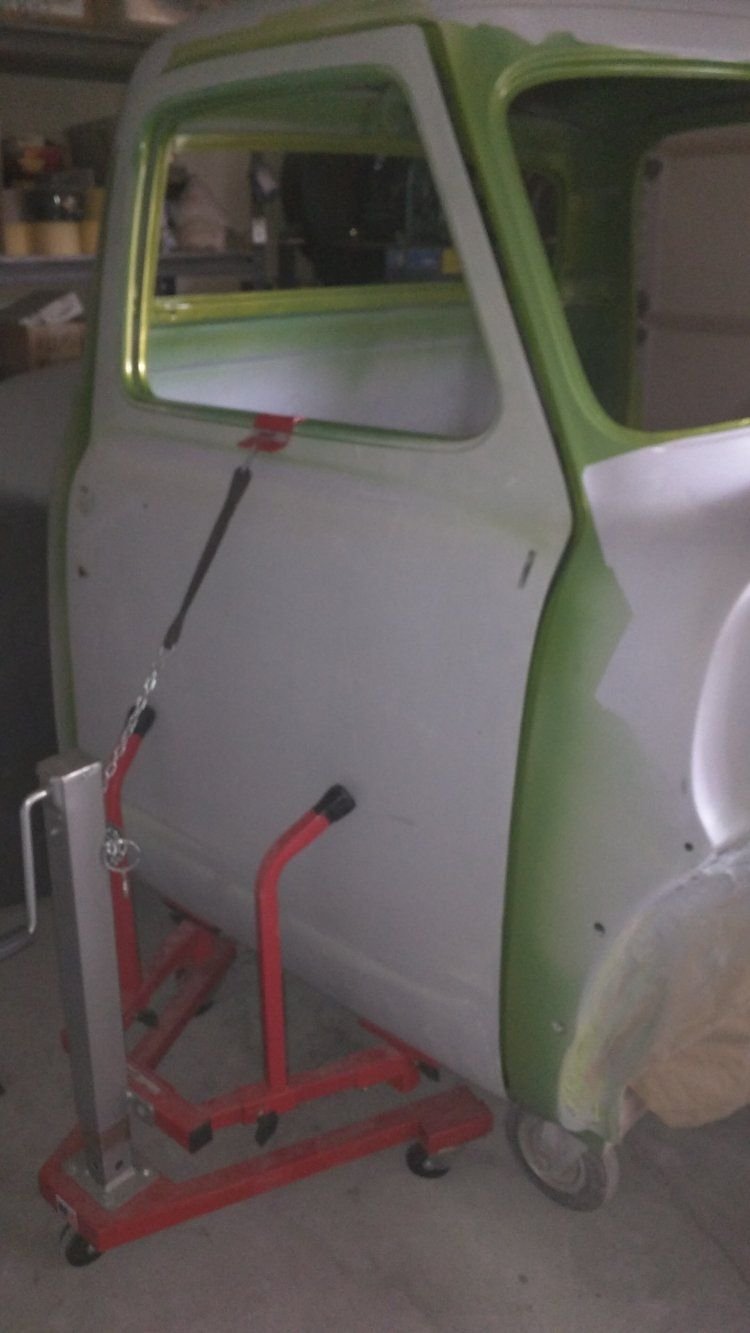

Indexing happens after you have the door in perfect alignment. The technique that I use is to drill a 1/8 inch hole through each of the hinge faces all the way through the sheet metal and threaded plate. When hanging the door again make sure that each hinge is in the same location and then insert a 1/8 drill bit back into the alignment holes you drilled earlier. This can be a challenge so I use and ice pick first to get the holes in rough alignment and then go to the drill bit.
If you are going to hang doors more than a couple of times you may want to consider a door dolly as pictured here...
