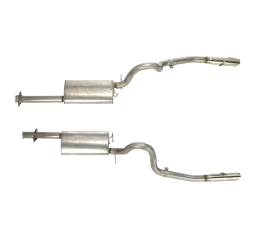

catback exhaust is any exhaust the attatches after the catalytic converters. it doesn't matter if it's dual pipes or not. there are 3 popular ways these usually go.
1 pipe into muffler, 1 pipe out of muffler
__________________________________________
1 pipe into muffler, 2 pipes out of muffler
exhast is split, and each side of engine gets it's own muffler and exhaust pipe.
1. the $350 quote is for a single pipe catback exhaust. basically he's going to cut your 3 foot stock muffler off, and weld in a new "performance" muffler with a little pipe
2. the $450 quote will have the guy "Y-ing" out your exhast and installing all the associated piping to have 2 seperate exhaust tips. 1 pipe into a muffler, 2 pipes leave the muffler
$450 for a custom dual exhaust isn't bad, it isn't the best of prices either. I paid $479 (shipped) for a Magnaflow stainless steel dual exhaust. I had to install it myself though. It all depends on how mechanically competant you are.

it's a style thing. one pipe in and one pipe out won't quite sound the same as 1 pipe in 2 pipes out, but it'll come real close.
I prefer the 2 tailpipes myself, but alot of people go with 1 pipe that looks stock.
