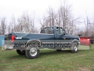

On my 97 there is a lot of rust developing on the body. I'm looking for a temporary fix just to make it look decent for a while as a work truck. The one spot that worries me the most is under the mirror where the old style mirrors used to be that rusted out. What does everyone suggest? Would sanding and painting these areas help?
