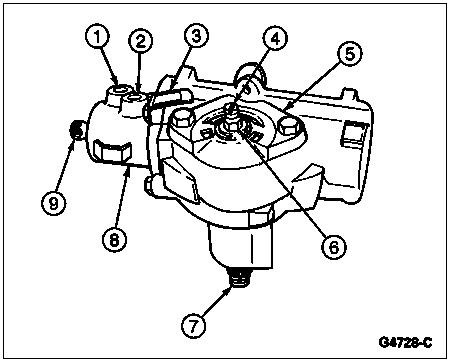

It could be the steering gear needs some lash adjustment. You can loosen #6 below and give #4 a 1/4 to 1/2 turn clockwise, then retighten #6.
-or-
This is the procedure copied from the book:
  • Adjust total on center load to eliminate excessive lash between the sector and rack teeth as follows.
  • With the engine off, turn the steering wheel from full right stop to full left stop at least once.
  • Remove steering wheel hub cover.
  • Disconnect the steering gear sector shaft arm from the steering gear sector shaft using Pitman Arm Puller.
  • Attach a newton meter (pound-inch) torque wrench to the steering wheel hub nut and determine the torque required to rotate the power steering gear input shaft and control back and forth across the center position (± 90 degrees).
  • Reset the meshload only if the measured torque for total on-center load is less than 1.5 Nm (13 lb-in). If reset is required, loosen the adjuster lock nut and turn the sector shaft adjuster screw until the measured total on-center load torque is 2.0 Nm (18 lb-in). Hold the sector shaft screw in place and tighten the lock nut to 48-61 Nm (35-45 lb-ft).
  • Recheck torque readings and replace the steering gear sector shaft arm. Tighten the pitman arm-to-sector shaft nut 230-310 Nm (170-228 lb-ft).
  • Verify no binding condition in steering throughout full stop-to-stop travel.
  • Replace steering wheel hub cover.
<TABLE cellSpacing=0 cellPadding=3 width="70%" border=1><TBODY><TR><TH vAlign=bottom>Item</TH><TH vAlign=bottom>Part Number</TH><TH vAlign=bottom>Description</TH><TR vAlign=top><TD>1</TD><TD>—</TD><TD>Outlet Port (Part of 3504)</TD></TR><TR vAlign=top><TD>2</TD><TD>—</TD><TD>Inlet Port (Part of 3504)</TD></TR><TR vAlign=top><TD>3</TD><TD>—</TD><TD>Identification Tag
(Part of 3504)
</TD></TR><TR vAlign=top><TD>4</TD><TD>—</TD><TD>Sector Shaft Adjusting Screw (Part of 3540)</TD></TR><TR vAlign=top><TD>5</TD><TD>3580</TD><TD>Steering Gear Sector Shaft Housing Cover</TD></TR><TR vAlign=top><TD>6</TD><TD>—</TD><TD>Lock Nut (Part of 3540)</TD></TR><TR vAlign=top><TD>7</TD><TD>3575</TD><TD>Steering Gear Sector Shaft</TD></TR><TR vAlign=top><TD>8</TD><TD>—</TD><TD>Control Valve Housing
(Part of 3568)
</TD></TR><TR vAlign=top><TD>9</TD><TD>3D517</TD><TD>Power Steering Gear Input Shaft and Control</TD></TR></TBODY></TABLE>
