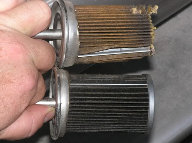

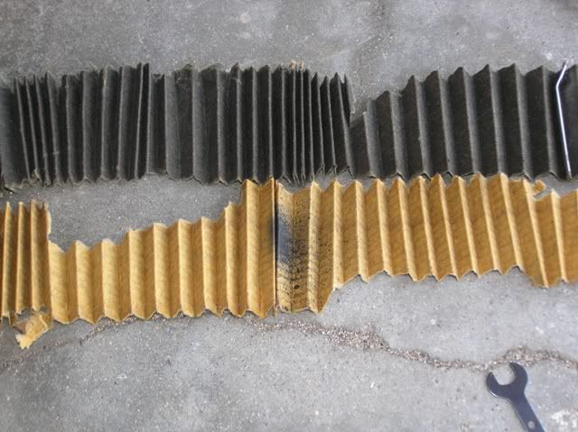

I change mine every 6 to 8 months.
Here is a photo comparison of my filter and my buddy's filter.
My buddy hadn't changed his in two years.
I have a custom tune with all kinds of mods done to my Lightning so I'm probably more diligent in regular maintenance than others who have just the stock setup.
Stewart
