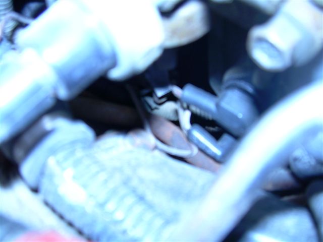

Does the tach move while you are cranking the engine?
No tach = bad CPS
Check # 22 fuse under the hood.
Blown fuse = shoted fuel heater element. Unplug element on side of filter housing. HERE
