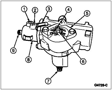

You can adjust some or all of the slop out of the steering gear. There is a lock nut and screw right before the steering shaft coming from the cab. You might need to remove the plastic cover that just clips onto the hoses/pipes coming from the pump.
Removing your driverside tire makes the job easier. You can work through the opening between the wheel well and frame. Lossen the nut while holding the screw. Do NOT let it move. When the nut is loose turn the screw clockwise about and 1/8th of a turn and tighten the nut. Check your progress and don't go too far too fast. Going too far will put a bind on the sector shaft and eventually ruin the steering gear. Keep in mind that some parts will wear out eventually so adjusting it may or may not work.
https://www.ford-trucks.com/forums/5...=steering+gear
I copied this from the factory service manual. It's more complicated than what's necessary IMO:
Adjust total on center load to eliminate excessive lash between the sector and rack teeth as follows.
With the engine off, turn the steering wheel from full right stop to full left stop at least once.
Remove steering wheel pad horn switch.
Disconnect the steering gear sector shaft arm from the steering gear sector shaft using Pitman Arm Puller.
Attach a newton meter (pound-inch) torque wrench to the steering wheel hub nut and determine the torque required to rotate the power steering gear input shaft and control back and forth across the center position (± 90 degrees).
Reset the meshload only if the measured torque for total on-center load is less than 1.5 Nm (13 lb-in). If reset is required, loosen the adjuster lock nut and turn the sector shaft adjuster screw until the measured total on-center load torque is 2.0 Nm (18 lb-in). Hold the sector shaft screw in place and tighten the lock nut to 48-61 Nm (35-45 lb-ft).
Recheck torque readings and replace the steering gear sector shaft arm. Tighten the pitman arm-to-sector shaft nut 230-310 Nm (170-228 lb-ft).
Verify no binding condition in steering throughout full stop-to-stop travel. Verify customer concern is resolved.
Replace steering wheel pad horn switch.

SWEET!...if you have pictures that would be awsome....I have since talked to my mech and he is singing a different tune about the play in the steering....but it's still there...It would be nice if i could adjust that....MAN THIS FORUM ROCKS!!!

Old Mar 2, 2007 | 04:52 PM
Cuda_jim's Avatar
Cuda_jim
Joined: Oct 2003
Posts: 5,903
From: MICHIGAN
https://www.ford-trucks.com/forums/a...achmentid=2444
Items # 4 & 6 are what you are looking for.
