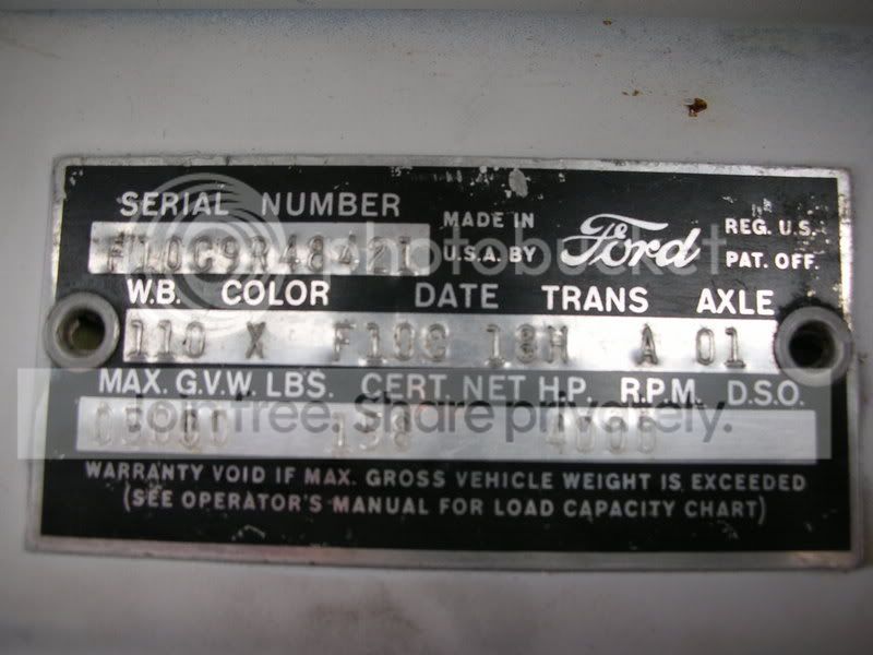

I'm at work, I will post the code tomorrow, I knew I forgot something....I think it was something like 18H , I think that was in the trans spot, its kinda stamped off center there was an A 01 in the axle location

Extra mount on transmission? On the bottom of the trans with a couple of holes about 4" apart, where a one piece rubber mount might go?
Passenger car trans, truck uses different mounts.
18H sounds like a Lincoln part from the 1940's, but there's no way that what that is...Lincolns have a flathead V12.

info plate
Here's the info plate
