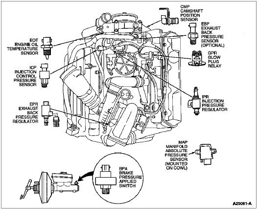

Her what I got from the tester. It says P0472 ( exhaust presure sensor Curcuit Low input.) and code P1728 Transmission slipping. Again I dont know where the exhaust presure sensor is to check it out. Do you guys think transmission problem can be caused by the sensor.

No, the EBPV sensor won't make the trans slip. Flush the tranny fluid like stated b4 but you likely will need a rebuid IMO.
The EBPV is located on the front of the engine it may be plugged with soot.
https://www.ford-trucks.com/forums/a...tid=2540&stc=1

Thank you so much guys, I will flush the trany this weekend, I ordered a new VSS from my part supplier I will replave it just incase. Also I noticed a cracked wire at the ebpv sensor connection. I realy apreciate your guys' help and knowlade. Thank you again.
