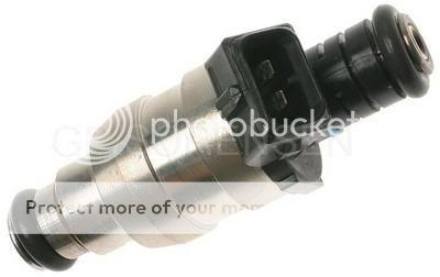

When I rebuilt the motor in my truck, I found several pintle caps cracked or broken. So I thought, what the heck, I'll just replace the injectors, and then if I later decide to get these repaired, I'll have extras.
Anyway, I bought new injectors at Autozone and they are different than the ones that came out of the truck. However, they look like one I had replaced a few years back that was found to be faulty. Now the truck is not running right.

Here's what the new ones look like:
Here's what the old ones look like:
The old injectors have the following on them: E5TE-A3B
Autozone's website says the new ones are for: E67E-B1A, E67E-B1B

wrong injectors! i re-installed the originals and it runs much better. I'll be taking the new ones back to Autozone!
