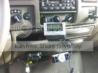

I have used a few different ones, but love the Prodigy the best. Here's a pic of mine, lower left.
