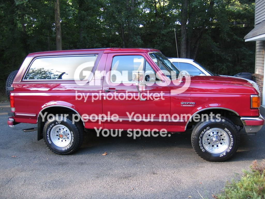

Mine was repainted and cleared by the original owner.

Gee, thanks David85719. I had just decided to just leave the top dull as I didn't want to start any body work on mine since it has a little "character" from a less than careful previous owner. Then you show me that good looking top of yours and I'm getting the urge to grab the ol' paint gun. Luckily (?) I've got my '66 F100 taking up the garage and it's about ready for paint and reassembly. I guess now I have another project to look forward to.... It's a good thing I enjoy this stuff.

David85719's Avatar
David85719
Joined: Nov 2005
Posts: 29
here's a better pic to help you decide.

Stop it! You're killing me! You've now created a new project for me! Good looking rig by the way.

David, and when is your schedule free to do my truck? I will need a little tan for the mid section though, just to warn ya.
Doe slook nice, gotta say.....
