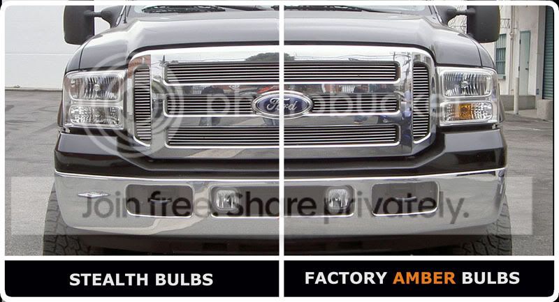

Old Oct 30, 2006 | 02:49 PM
StealthAuto's Avatar
StealthAuto
Joined: Jun 2006
Posts: 60
I hope you found the lenses you were looking for! I know the corners do in fact have an orange lens which would need to be swapped out but also swapping out the amber bulbs will make a huge difference.
Check out the image below of a Ford F-250. As you can see, the bulbs are the only thing reflecting the amber color in the front.
Below are before/after images of our Stealth Bulbs on a Lightning.
To see an article Ford-Trucks did on our bulbs CLICK HERE.
Good luck with the clear corners and feel free to contact me if you have any questions!!
-Aaron
