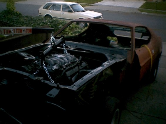

This is the closest pick that I have. That's actually when test fit the v10 in my parts car (the 73 fastback) while the Boss was getting it's K-member put in at Grigg's racing in Sonoma.
