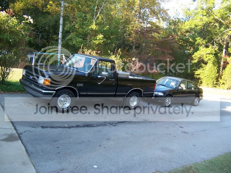

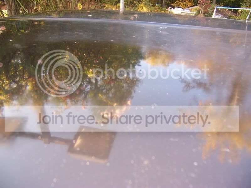

Heres my new 90 F-150. I did add the rims last week when I first got it. The whole truck looked like the unfinished sections of the hood when I got it. Enjoy the pics.

get that hood finished!
what are the specs?
looks like a nice truck.

Ill get it finished soon. Its just a lot of wetsanding and buffing. And Ive still got the passenger side and tailgate to do.
Its got a 302, its an auto and has a custom cracked windshield. A/C, power windows, locks. Nice little daily driver.

Does look like a nice daily driver nice lookin truck gotta love that black and its in such good shape too

Ok, now that my dad knows Ive been wetsanding the paint he says you cant do that unless you put clear back over it. Where the heck do people come up with this crap?

He's probably thinking of the newer paints, when they put the clear over the base color(Stage II paint job), in which you would have been sanding off the clear and it would be a good idea to put a clear coat on it. However, these older trucks have a Stage I paint job, where the paint already has some clear in it to give it the gloss. It shouldn't hurt yours to wet sand, and obviously you dont even have any scratches, so congratulations and good job.
