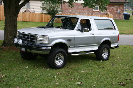

I have a 2 1/2" lift kit on my Bronco, I prefer the 15x10 wheels with 33's. The first picture is with the lift with 15x8 wheels and 32's, the second picture is with 15x10 wheels and 33's.

94, that is one sweet ride. When mine grows up, I want it to look like that.

94 XLT could you post a pick of your tow hook from underneith, i was wondering where you attached them to so that they would stick out the front. thanks

Eddie if you click on the picture you'll see all the pictures for the tow hooks. The hooks came from a late model Super Duty.
