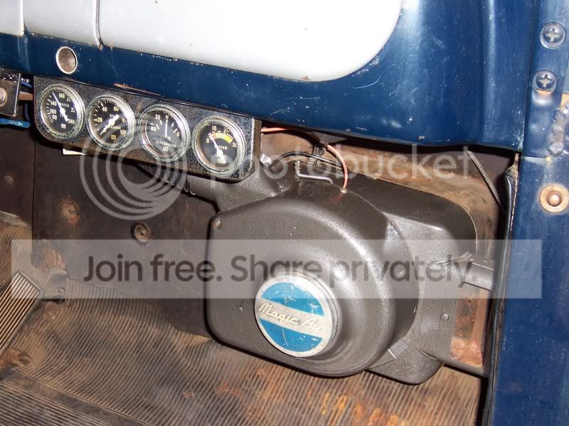

Gentlemen and some ladies,
Is there another 12v heater motor that fits the original case without buying the expensive one from Midfifty or Bob's F100?

Look for an older Escort heater motor. THese were used from 57 up thru the late 80's. You can still get them new from Ford.

Don't get sticker shock at the parts store, for some reason all heater fan motors are expensive >100.00 new, 60.00 + used. Mid fifty's price is not out of line.

Hope it's not too late, I went to the local parts house and they looked it up in an old book. Had both 6 and 12 volt in stock. I believe I paid $42 for the 12 volt. I'll see if I can find the part number, if you still need it.

Also, for what it's worth, I installed the motor from a '79 Econoline in a 53-55 heater box once; had to enlarge the hole an inch or so, but that was easy enough.

I bought it in Gainsville, GA at a local parts house called "Slack Auto Parts" (no pun intended, because they certainly aren't) The part number is C/T35576 and it was actually 39.99 for the 12 volt. The phone number is 770-535-6000.

got the heater motor but i have to enlarge the hole quite a bit....$12 bucks from ebay..

okay...the heater motor from ebay is way to large....i tried to modify it but the bracket that has the motor on it is not giving in...also the fan piece is WAY to large...spent about 45 mins trying, measuring before cutting my original heater box....NOW for the good news......slakautoparts .com is the perfect place....just ordered my 12v motor $50 bucks....$12 shipping...$62 total...so Doug51F1 has the perfect option...once it gets here i will show pics of it in my gallery....this forum is the best gents!!!!!!!

The one that I bought fit right into the housing on the existing heater and has been warming my cab for a few weeks now.
